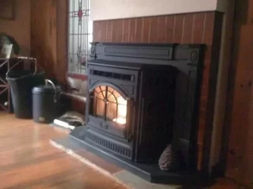

thanks everyone for the input... I decided to purchase the castile... its beautiful and works great.
thanks again
Good luck with your Castile. I'm sure that you will be happy with it. Keep us posted with your installation, first burning, etc. We always like to hear how things are going for each other.

A photo when you get it installed and running is a must.
Hope everything go well. Also your up and running quickly. And it keeps you nice and warm.
