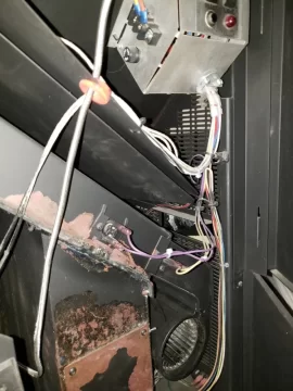

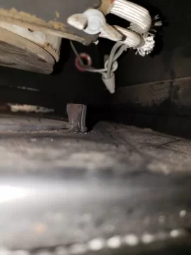

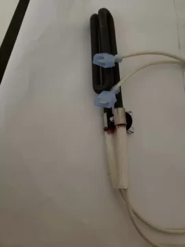

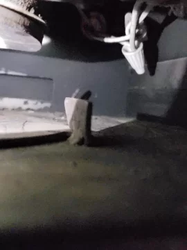

So after another 2 days of stove running fine, we woke up to smokey house due to pellets not fully burning in the burn pot or stove running. Call light was still on and our wireless thermostat said it was on. So after checking burn pot, it didn't seem bad at all. I did scrub it all out though anyways. Also removed Exhaust Blower and Cleaned in there and put new gasket on. There wasn't much at all in there either. I did go to a Stove shop today and bought a new Igniter to try to install and see if that is the issue, but I'm not sure what to do based on what I found. I'll include pics too of new Igniter and pics of old igniter and wiring. The new Igniter has two prongs to connect to something, but my igniter looks to be maybe spliced and capped off under the burn pot and then the wire it's connected to goes straight up into the Control Panel box. Is that normal and is anyone else's setup like that? I'm really hoping to get this up and working.

How old is your stove? From the pics, you have the old style igniter that used ceramic nuts to splice wires together, but those don't look like ceramic. Surprised they haven't melted if they are. The igniter you bought is the newer style that goes up thru wall and plugs into wire harness. With your random shutdowns, make sure the firepot thermocouple cover is clear of any ash and make sure the tc is touching the inside end of the cover or it won't read right. Make sure it is sticking inside pot at least 3/4". Also make sure the auger isn't reversing, and not feeding. You will have to watch stove and see how things are going. You can feel the auger turning just below motor. kap

There can be issues with after market parts yes. The add says it is OEM part, so should be good. If your igniter is getting hot, it is good. No need for a new one. You might get lucky by cutting ends off and using it if you need it. There are a number of things that can be causing your issue. Can only do process of elimination till it is found. If stove is no older then that, someone cobbled the igniter wires at some time. kap
