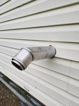

How is it vented? Can you post a pic of it burning?

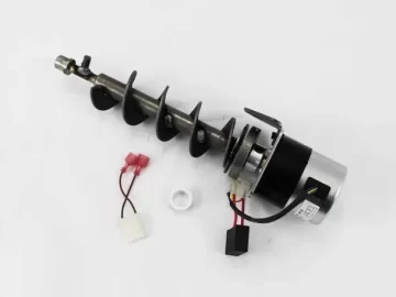

It says 2013 model. The spring is hollow and thought about adding a 3/4" pipe down the center of the auger to see if any changes. Any thoughts on that? Like this one

Did you double check and make sure the setscrews are tight from the auger to the motor shaft?

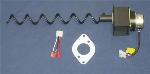

Correct auger:
[Hearth.com] Quadrafire CB flame help

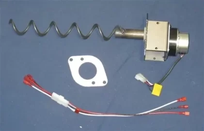

Incorrect auger:

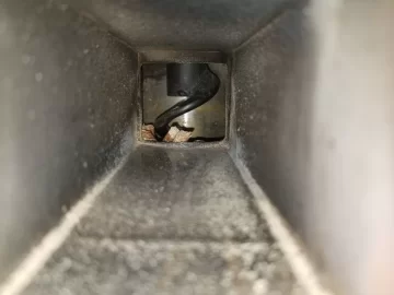

Also take a mirror and look up the drop tube and make sure nothing is jammed up there keeping the pellets from dropping.
