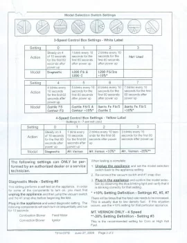

Problem solved. Had to take control panel off test setting with the dial on side of control board. Any way to increase feed rate other than using manual feed adjustment? I have it opened all the way and fire is way too small.

You have the control set to #1? If you change it to #2 you'll get 10% more. Shut it down and wait for it to cool. Unplug the stove and change setting to 2. Plug it back in and try it again.

Ok I've been looking and can't find the 10% . Feel like I'm missing something !
It's under warranty right ??

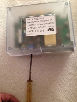

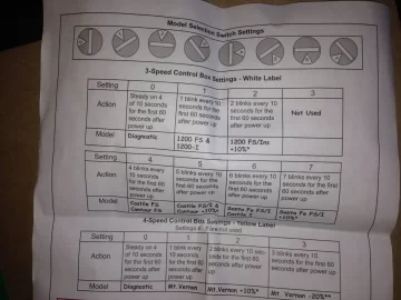

The control board has a "Dial" on it. You must unplug the stove, remove the board, change setting, reinstall, plug back in and start up. Gives Low a little extra Umph! (Gives every heat setting 10% more, but I lile Low).

ive been looking thru the manual for a used quad cb 1200i that i bought recently and i dont see any mention of the control board settings.Dexter day posted this page from something.is there a install manual or tech manual available for this stove.
Could be the pellets you have now, If you get too much heat out of the next batch of fuel you'll need to change it back to #1.
X2
Pos 3 is not used. :)
The instruction sheet comes with a new control panel.
See pics below - Click to Enlarge
  • [Hearth.com] Quadrafire issue
thanks don.the stove i just picked up seems to be set on 1 which is the correct setting for the cb1200 insert.im a little surprised this info isnt in the owners manual.also i saw nothing in the manual for gaining access to the auger motor which is in the hopper.
