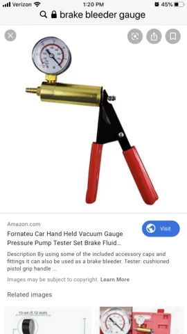

I had a vacuum switch problem on a friends stove. She went to the stove store and bought a new vacuum switch. Turns out the exhaust blower was bad and after I replaced the blower I was a bit bewildered because it still had a vacuum error. The store probably tested the switch with an ohm meter and it did close when sucking on the switch port so they put it back in stock.
I tested that new switch with my brake bleeder Guage from harbor freight to see if The bladder inside holds air by pumping some in and checking the Guage to see if it holds steady. It leaked air like a sive! I tested her old vacuum switch and it worked fine so when we put that switch back in with the new exhaust blower, the stove was fixed!
It may not be the case with your stove but I always test bladders not micro switches in vacuum air pressure switches to be sure they are good!!
