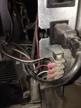

Just double-checking, since the owners manual doesn't give a hint about which wires are which and my wife HATES it when I pull out tools of mass destruction without reading the directions:
1. I assume that the three wires coming in at the front (just below the power cord) are coming from the wall control since they are branching out of a white wire cover. These are the wires you suggest re-wiring?
2. The three wires that go out the back of the plate have a zip tie about 8 inches back, barely visible in left side of pic. Unzip that tie?
Not sure of anything else that would be moving since the stove has been in about 6 years and the problem didn't show up until this summer, but I'll go see what I can see where the wire is visible through the basement.
You are correct. Just make sure to unplug stove first, and color coded wires back in same place. kap
