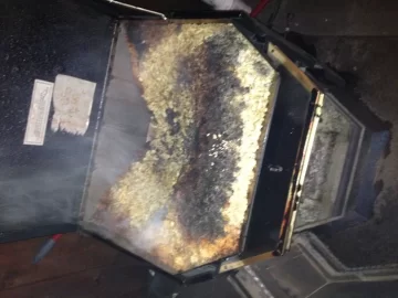

Hey everyone, I came home this morning to something I never wanted to see. The co alarm was going off, and the hopper on my stove had caught fire, and burned itself out. Has anyone else had this happen? Is the stove still ok to be used after a good cleaning? It's a whitfield quest plus, I'm not sure how old it is. I've burned about 10 bags through it since purchasing the home it was installed in.

I would not use it again until I found out why and how fire worked it's way back to your hopper, I'm not familiar with you stove but it sounds like a auger took a dump. Did you loose power last night? Are u sure it was a hopper fire?
Sorry I can't offer any other help. All I can say is after that there is no way I would just clean it and fire it up again.
Well there was plenty of burnt pellets in the back of the hopper. There was no loss of power. The auger has been sounding a little different at times, but it sounds like its not feeding... It did its job and smothered itself out, I'm just trying to find out what I need to do now...
Is there a dealer around you that can make a service call? Personally without a pro looking at it, I'd take it to a scrap yard.
My inclination is that the hopper lid could be leaking air. Was it perhaps left ajar?
The normal cause of hooper fires in a top feed stove is lack of combustion air (all of the normal culprits apply beginning with a dirty stove system).
It starts with pile up in the burn pot followed by the drop tube filling up and the fire smoldering back up the drop tube and into the hopper.
You need to clean the stove up and check every motor for heat related damage including the auger bearings, then every gasket needs to be tested or just plain replaced.
Your stove did its thing and the fact that the fire smothered itself indicates that the hopper lid was indeed closed.

Smokey, I performed what I thought was a pretty good cleaning last month. Took the fans off etc, blew everything out and cleaned everything that I could. I had to have the damper closed, and the combustion air setting turned the whole way down, and it was still blowing some of the pellets out of the grate. I cant really see that's how it would have been a lack of combustion air... I'm not saying your wrong, it just doesn't make sense. And you were correct that the lid was closed.

i see you purchased the house and this unit was already in it, in order for this to happen usually the stove's exhaust pathways have to be badly plugged up.
i'd suggest a deep cleaning in behind any access doors and panels leading from the firebox area back to the exhaust blower, had the auger motor died the feed would be cut and it would go out as if you turned it off. to build a "powder train" back to the hopper, for this to happen you would have to have had the fuel build up to the chute and fill it up. sounds like the stoves just not breathing well to me

If the stove was pristine in the ash department then you are reduced to gaskets and the door latch as a second level cause, however you should not have had pellet pieces being ejected if this was the case.
Third level would be combustion blower slowed down but you should have noticed the fact that pellet pieces were not being ejected or the flame color was wrong or the burn pot was building up.
When the stove is properly adjusted you should be able to see the burn pot grate at all times, your flame will be very bright, and there will be blue flame just above your pellets. The pellets will wiggle in the burn pot.
If your stove is vented into the wind you can have burn issues normally these burn issues are the result of reduced fuel flow due to the vacuum switch not always being closed interrupting some of the fuel flow. This would rarely lead to the issue you encountered.

could have been a "starve/smother" when you have too much combustion air you could lose the fire down to coals this would result in the stove having to relight off the coals, if it takes too long to do so the resulting drop in temp could take the stove below the "low limit" and have it go to shutdown, now during this time the coals are starting the pellets up slowly and the result is the fuel piled up finally lights off and burns its way up the chute afetr the unit has shut down. this could take a pretty long time to work its way back due to the smouldering effect. looking at the pictures i see the burn pot is loaded all teh way up with ash. this is way too much ash to be present in the burn pot and supports the loading of the chute theory, notivce the color of the ash is white as well, i see this color ash in unplanned shutdowns during power loss situations as well as a sytarve smother when the stove shuts off before the fire is out.
The stove was installed in the house I just purchased. I posited a thread before to find how to clean the stove. I cleaned everything I could, pulled the stove outside and cleaned the small 2 feet of flue attached. I then blew the rest of the ash out with a leaf blower. I also removed the exhaust fan and cleaned all of the blades on it. I then put it back together and replaced the gaskets on the door. Since then I have burned around ten bags.
It looks to me as if the fire went up the chute to the auger, at the same time it choked itself out for lack of oxygen. The heat buildup also caused the top of the pellet hopper to begin to light. At this point it burned all of the oxygen as it burned out. That's my opinion
