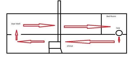

Here is a pic.
Simple representation but it works for me.
I have a vent above the stove also.
Fan on low blowing down into the basement will slowly pull air towards the other end of the house.
My house is like this drawing , stair well at one end and a hall way that leads to bed rooms at the other end.
My house is very well insulated and energy efficient windows.

I have one vent that was left from taking my duct work out from my old wood furnace. I turn the fan facing down blowing the air down into the basement that then helps pull air up into the house from the stair well and the other vent that is above my free standing stove. My vent above the stove was in the house when I moved there, some people that live in areas that are more populated have building codes that prohibit this type vent above stove.
If you get a quantity of air flow down that way it will better heat that end of the house but its not gonna make all rooms the same temp.
My bed rooms are approx 2 degrees cooler keep in mind my house is very well insulated.
