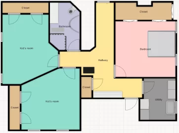

I am hoping to heat a wing of the house, about 1,070 sq ft. Ceilings are 8 ft. Insulation is average?
I live in PA, and I'd like to supplement the existing heat pump/use in the case of losing power/extremely low temps as a stopgap.
The black rectangle in the hallway is the planned placement of the stove.
The alcove is only 2' x 3' - so you can see why I am looking at these tiny stoves.
We would run a new chimney, and install some sort of venting to draw the heat from the hallway into the bedrooms.
Suggestions appreciated, I am concerned with how "chopped up" the space is and how the heat would travel.
Thanks!

There is a big difference between the EPA tested heat output of a stove and marketing numbers. Morso's are the former and the US Stove numbers sound strongly like the latter. They are probably peak output numbers.
Heating from a hallway is going to have mixed results. The hallway will get hot, but that does not ensure good heating in the bedrooms due to convection issues. " install some sort of venting to draw the heat from the hallway into the bedrooms" - What are the thoughts here?
What is under this section of the house? Is there a floor below this where the stove could be located? That might ensure more even heating.

Any "venting" would likely have to be done by blowing cold air to the stove from the adjacent rooms. I.e. a fan on the floor in every door opening blowing slowly towards the stove.
Or better some thru the wall fans.
But it's going to be hard, as begreen says.

This section of the house sits over a crawlspace, unfortunately.
RE: Begreen & Stoveliker - Yes, the idea was to install some through the wall fans/vents to draw warm air into the rooms from the hallways.
Something like: ThruWall Fan installed above the doors to the bedrooms, blowing rising warm air into the rooms, with cold air dropping and exiting under the door through the gap between the door and the floor back into the hallway. Does this sound like it might work?
Do you have any other ideas that might better circulate the air through this wing of the house?
Thanks for all the help!

I would instead have those fans near ground level pushing cold air to the stove, and cracking a door to let warm air in. Moving cold air is easier.

With three of those fans running it's going to sound like a beehive. Is this a tri-level where there is a living area down the steps? If so, heat will convect up from the main area if there is a stove there. The rest is up to the quality of insulation in the bedroom level.

Stoveliker - If you put a fan on the floor blowing cold air, how do you keep the rooms warm when the doors are closed? Or do you just default to the doors always being open?
And, "Moving cold air is easier." - Is that because you can blow it, whereas hot air you have to suck away from the stove?
Begreen - The house is all one level, this is a separate "wing" with all the bedrooms. And I prefer to think of the fans as a pleasant hum. :D
I will try to get ones with a low noise level, but I think the end result either way will be one big fan or a couple small ones.

You need to have flow of air, the best way to do that is to have an entrance and exit point, so yes, keep the door cracked open if you put a fan in a wall.
If you put a fan on the floor in the doorway opening it needs to be even more opened.
stoveliker
Nov 17, 2019
7,261
Long Island NY
With the fan on the floor in the door, you need to run it on low, otherwise the air mixes too much. Keep a cold air flowing out at the bottom and warm air in to replace that at the top. Keep it stratified.
With a fan in the wall a bit away from the door you can run it harder.

It looks like there is a 2-3 step stairway up to this area showing at the bottom of the image. Can a stove be placed opposite this area? If it had a blower the convected heat could be directed toward the hallway.

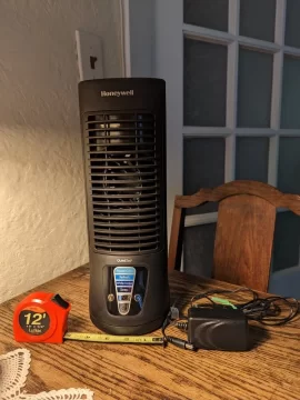

We use this mini tower fan not to move heat, but to cool our "hotdog" when he's trying to sleep; He likes it a bit cooler than we do. 😏
It's only about a foot tall and has a small footprint, so it isn't in the way as much as an 8" fan might be. It doesn't move a whole lot of air, but might work well enough moving cool air out of a bedroom back into the stove room without having the door all the way open. It's very quiet as well, compared to the 8". I use a couple of regular size ones as well when I'm not running the AC, and it might be slightly warm and humid...one at my computer desk and another at the recliners by the TV.

A useful thing here is the historic heating bills over the last couple years. Besides boiler fuel, look for spikes in the electric bill suggesting electric heaters were in use. Do you smell kerosene exhaust anywhere in the house suggesting off books BTU consumption?
Once you know historic boiler fuel and wintertime electric usage you can get a handle on BTU requirements for the envelope you have, but you will never really know how warm the previous owners kept the space.
With a chopped up floor plan like you have supplementing the HVAC system you have with a wood burner is about all you can do, and the greyed out area is as good a location as you can hope for.
