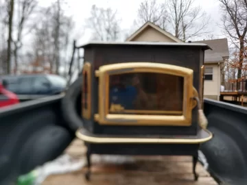

Hello all. I've been lurking on this site for sometime now. I've been around wood stoves my whole life. I'm getting rid of the old death trap logwood 2421. I purchased a used Buck Model 81 well worth the money a couple days ago. My question is I know the Buck calls for a 6" chimney. When I started pulling apart the block off for the fireplace I found that the previous owner of my house actually did a good job and had a 8" fully insulated chimney liner installed the full length of the 25ft exterior masonry brick chimney. My question is will it be ok to do a complete sweep of the existing liner and insert the 6" liner inside of the 8"? I have already figured out how I plan on supporting the 6" liner inside of the 8" I just wanted to make sure I'm not going to cause any issues.

Everything was cleaned yesterday. Whoever installed it did a really good job. The fireplace is a monster at 44" w 25" d and 32"h. Even though the Buck 81 is a pretty good size stove it's going to look small inside of it. But only giving $500 for the stove I can live with that.
