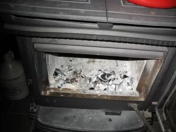

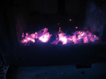

I am posting this to illustrate what I see after a 10-1/2 burn with 200* stove top temp. The wood that I burned was a mix of some large red oak and ash. I raked the coals forward this morning and had relight in seconds. The non-flash pic is a bit blurry I should have used a tripod. The wood I am burning is seasoned and if you're burning damp wood that will leave much more coals plus you will realize less BTU's and more creosote, dirty glass, etc..

  • [Hearth.com] Question about excessive coals
