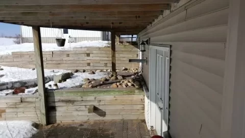

A piccy of your pipe and such from the direction the wind comes from maybe 20 feet away would really help us offer better advice.

the exhaust comes out under the deck on the south side of the house.
Reactions: bogieb
I was under the impression that any venting under a deck was frowned apon. You certainly seem to have plenty of space though.
Reactions: bogieb
I have no idea if its frowned apon. I bought the house with the stove already in it.
Just for you own edification, check out the stoves installation instruction or your town code.
Not trying to break chops, but it may be for your safety.
Also, how far is the vent termination from your door? There needs to be at least 4' between the two.
