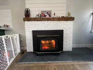

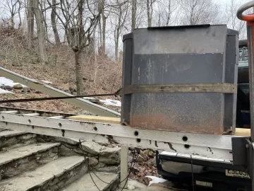

Hello everyone, just picked up and installed a lightly used Harman Exception Model F200. Insert is from 2004 and the brick, afterburner and afterbuner hood are in perfect shape. Looks like it was never over fired.

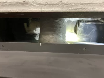

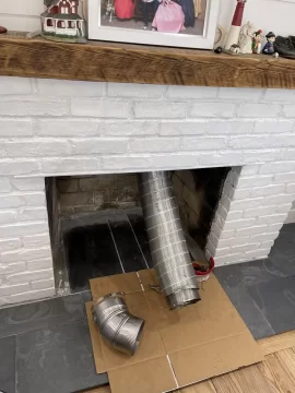

I installed a insulated flue liner thats about 17'. When this baby in in AB mode with it lit, WOW.

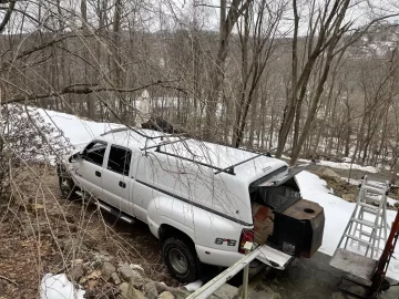

Some shots!
