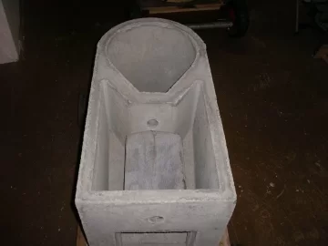

[Hearth.com] Question about jetstream boiler

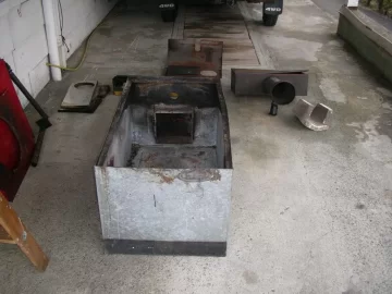

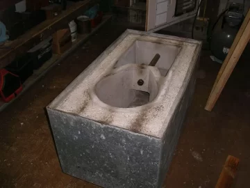

This is the heart of the Jetstream, the refractory liner. The round section is the burn chamber and the rectangular is where the ash particles settle out before passing up through the heat exchanger. The nozzle sits in the center of the ash settling area, the ash clean out opening at the bottom.
Most common area for the liner to fail is between the two chambers.
For example, if the wall between the two chambers has failed and you have to make a new nozzle, a new stainless steel combustion air injection pipe, plus the stove cement to make the gasket between the base and heat exchanger, you can expect to put out some where around $ 800!
This is the complete new base, liner with insulating vermiculite between the liner and the sheet metal box. 1,400 lbs approx.
When the heat exchanger is mounted on top the base, 1 inch of stove cement is spread over the base surface to form a gasket. You cannot skimp on this gasket as it serves two functions; firstly a gasket and secondly it provides for good heat transfer between the base and heat exchanger.
[Hearth.com] Question about jetstream boiler The sheet metal box with clean out opening and round hole for the combustion air tube.

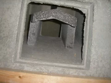

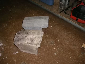

Looking in the clean out opening with the nozzle in place. The nozzle is a maintenance wear item that has to be replaced every 5 to 10 years and can be easily inserted in through the clean out door without dissembling the boiler.
[Hearth.com] Question about jetstream boilerTwo home made nozzles, fairly easy to make. Kerr Controls in Truro, Novia Scotia I believe still stocks them.

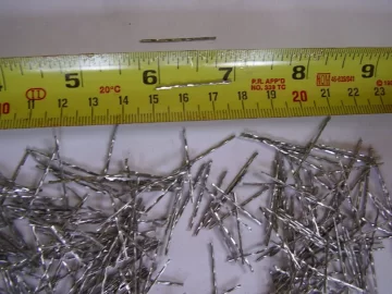

These are stainless steel refractory needles used when mixing refractory. High temperature mini re-bar
For me these boilers are fun to play with. Also I believe the manual's instructions for curing refractory are inadequate. I've learned the hard way!

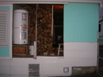

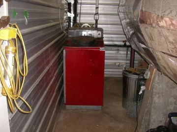

Storage 1046 imperial gallons. Boiler and storage share the same water with open to atmosphere expansion tank on the floor above in the wood shed. DHW and house heat are supplied by two copper coils inside of the storage tank.
Units are identical in size. The one in the Kijji ad is a Kerr Controls unit made in Truro, Nova Scotia

Storage is higher than the boiler for two reasons;
1 When boiler is out water stratifies so no gravity circulation between storage or boiler creating stack loss.
2 Should there be a power failure while boiler is firing heat will dissipate by gravity to storage.

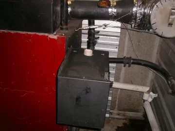

Some of the units have a belt driven three stage blower. If yours does find someone who knows how to take it apart to change the bearing, which are off the shelf at any automotive parts shop ($ 5.00 apiece). The aluminum blades are fragile and are not replaceable. I did it myself and damaged one of the blades. the new blades are metric in size and just a bit smaller and will not deliver the necessary air flow.
These belt driven blowers were used for cooling late 1970s main frame computers so are obsolete.

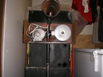

This is the smaller blower housing that has a two stage vacuum cleaner motor for a blower. One motor and three sets of brushes are worth about $100 and will yield about 2400 hours of use.

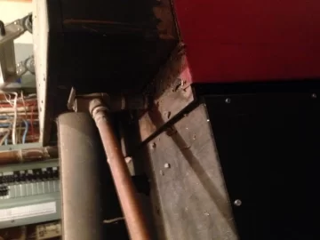

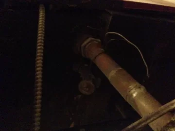

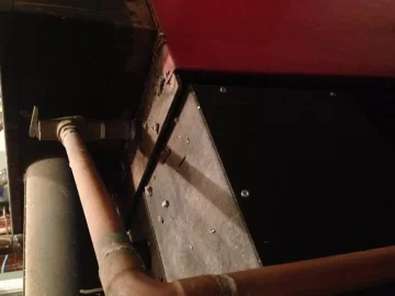

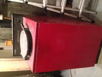

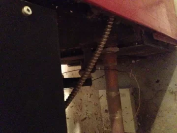

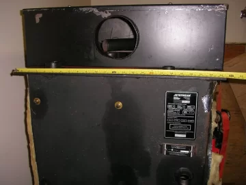

I bought a house and there is one of these installed. Can someone tell me exactly what it is and what it's meant to do? We are actually renovating and will be looking to sell it. Any idea what it's worth? The sticker indicates Series 120 SB, Hampton Technologies, Charlottetown, PEI. And yes I've been googling and I found a Popular mechanics article but I still don't know what it's worth, if anything.
Could you post the serial number, and maybe a few pictures?
I can't see it. There is a big black box in the bag perhaps covering it. I've gone around the whole thing and I cant see one.]

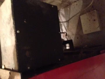

The big box is the blower housing. The boiler came with to types of blowers and your unit has the better blower.
Do you have a manual for the boiler?
