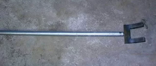

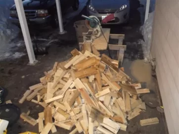

I have burned tons of pallets, I use them kindling and for getting the fire going quickly.
I like to keep a supply in the basement in case I don't want to go outside to bring in more wood.
The best way I have found is to take them apart with a pallet fork, and cut them with a chop saw.
An inexpensive carbide tip blade will go right through any nails.
If you can get the ones with oak 3 x4 they burn almost as good as cord wood.
