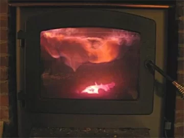

If you’re new to wood burning with a new stove, slow and easy wins the race. You will find your niche with your stove.....cold starts, getting a good coal bed, when to add more fuel, sweet spot for your draft control, split size...you get the idea.
Your stove may differ...But most of the time my Oslo's front draft control is 75% or more closed. On the really cold nights, I'll get my Oslo up to 600 and really char the wood before knocking the draft control down.
Here is what secondary combustion looks like:
20 minutes into secondary burn
Wood:Shagbark Hickory
Stovetop temp:600
Draft control 75% closed
