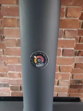

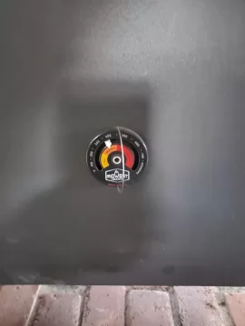

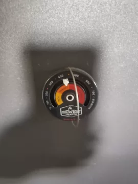

First pic is obviously stove pipe temp which is about where we keep it on average second pic is in the area where the fire bricks line the box and the third pic is above that area.
So I'm chalking the difference in paint color is related to a difference in temp of these 2 areas curing the paint differently?

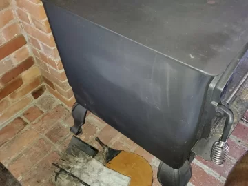

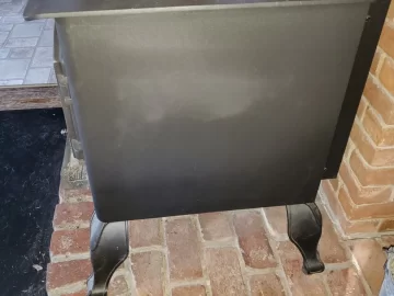

I mean there is no warping of the metal etc or anything of that nature just the paint has faded differently is all I can see.
I suspect the temperature difference has likely been greater at some point in time, than what you show here, to see that difference in color. But no worries, with age and time it should all equalize, unless the paint was baked very hot, at a temperature the brick will never permit.
