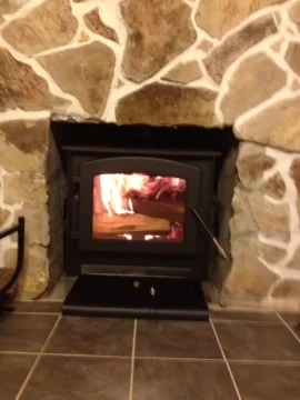

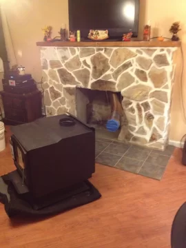

I have a soft spot for the nc-30, my buddy and I installed one in his house last October, He has a small place, although it is poorly insulated he made out good. This spring we are going to take down the mantel, insulate the chimney, an redo some windows. From what I have seen (which I like) is the NC-30 burns great, north/ south loading +++, good coaling which is nice because you can keep a fire for 12 hrs no problem. The stove is built rock solid, better than my stove lol .
