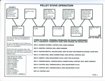

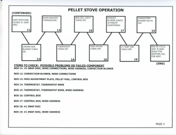

The larger red light is the "call for heat light" if that light is on the thermostat is telling the stove it needs to be putting out heat. If the fire has been going for a little while the control box will also have a red light on as well. the red light means the control box is receiving a signal from the thermocouple over the fire pot, the little white ceramic projection sticking into the fire pot, that it is something like 900 degrees F or more. If you watch it on start up you'll notice it has no light on till a flame establishes, then a green light comes on, as soon as the green light comes on you'll see the stove start to feed pellets, then later after having the fire for a little while longer it will turn from green to red which then turns the igniter off.
As far as the small white dial goes, if your looking at what I think you are, looking at the dial straight on you'll notice a pie shape cut out and a number visible. The same control board is used in the CB1200, sant fe, and castile regardless of insert or freestanding version. the number selected will change depending upon what stove it is put in.
The green light comes on at 200 degrees and starts the feed. The red light comes on at 600 degrees and shuts off the igniter. All normal. Your dial should be set at 6 and have 6 flashes of the blue light when first plugged in. If you turn it to 7 WITH THE STOVE UNPLUGGED you will get 10% more feed time but you shouldn't need it. You've already discovered that EVERYTHING in your cabin is a heat sink and not just the walls so it takes a lot of BTU's to bring it all back up to temp. The little Sante Fe with it's 30,000 max btu's can do it but it will take a long time from that low of a temp.
