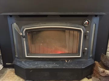

For reference I have either a H2100 or I3100L regency model insert. I am trying to figure out the best placement for the thermometer on the insert (see attached photos for where it is now). It seems to be it might not be getting a perfectly accurate reading (possibly a little cooler than it should be), so wanted to get advice on where is best to put it. Thanks a ton!

What about for me? Check the picture out and is that the best placement? Also, any thoughts on if it would be running cold for any reason?
Yes, that is as good a placement location as any. It may read a bit cooler, especially with the blower on. Turn it off for an hour to see if that makes a difference.
I thought you mentioned it could be as much as 100-150 degrees cooler, is that correct with this setup? I haven't seemed to have gotten the temps higher than 475-500 even with 4 decent logs just loaded. Shouldn't I be able to get it up to 600+ degrees?
