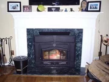

I have a Jotul 550 Rockland and had clearance issues with my mantel as well, Jotul makes a deflector shield that bolts behind the surround with one bolt and should give you enough clearance. I believe the shield was about $80.00 but was on a long backorder at the time. I included a pic of mine.
