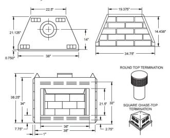

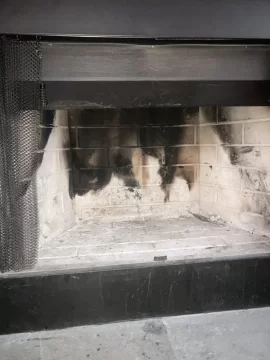

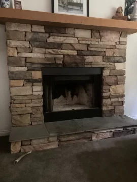

We bought a house with a factory fireplace. I am looking to put an insert in it. Our local installer is recommending an option that does not fit the aesthetic we are looking for. Our firebox is 35 7/8" wide at the front, 19 5/8" wide at the rear, 16 7/8" deep and 22" tall.
[Hearth.com] Question - Small Insert in Factory Fireplace
We are being recommended a Regency I1150. My wife is not a huge fan of the classic style. The more contemporary option, Regency CI1150, we're told is to tall to fit.
Is anyone aware of other options that would fit this small-sized factory firebox? It seems either height or depth are the main constraints for us.
Thanks so much in advance.
View attachment 284025What a wealth of information in here. I'm hopeful some of you can help as I am new to this world.

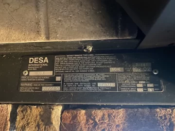

What make and model fireplace is it?
The DESA manual asks that an insert be tested for use with the firebox
Ok is the regency tested with that firebox?

Have you talked to desa to find out what inserts were specified for their fireplace?
The installer is good with it because he wants your money.
The inspector is good with it because he didn't bother to read the manual or label in the fireplace. And btw the inspector assumes absolutely no liability at all for things they miss. Just look at the lopi insert and insulation thread. An inspector passed that train wreck.
DESA is no longer in business.
Then you are pretty much out of luck because even if you could figure out what inserts were specified if any. They would no longer be in production regardless
