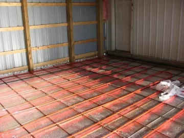

I have a detached garage with in floor radiant heat piping installed but not hooked up. I dont want to heat it all the time but heat it for a weekend here and there when im working on a project. I was going to use a propane hot water heater and fill the system with glycol since it wouldnt be heated all the time but now I want to consider the possiblity of hooking it up to my house wood boiler system. It really could not handle the load all the time expecially when its sub freezing out but I could fire up the oil beast for that if needed...

Woops another IMPORTANT question about piping to a detached building.
The garage already has PEX in the concrete floor, layed years ago by a contractor, I dont dare try to drill/penetrate the floor to bring the underground PEX into the garage. Since its going to have glycol in it, can I just bring it up out of the ground and come into the building above the slab through the wall? I could insulate the insulated pex (provide a box shelter at the penetration) Would this be OK other than looks and possibility of damage cause its exposed?
Im looking at using a prefab underground PEX piping someone at work is selling, looks cheap but it is oxygen barrier and is two pex pipes wrapped in what looks like thick felt inside a black corrugated pipe.
