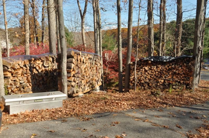

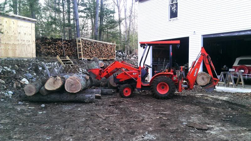

I use 24" lengths, I'm 55 years old and like to be physical but I try to do things as easy as possible. I try to cut to 4' lengths in the woods and bring them out with the Kubota.
Depending on the size I fill the front end loader then use the back hoe and get them out.
If I can I will keep them long but most of the time it wont work like this.
If I need to put them on the trailer I will lay them in sideways so they will roll out and buck every other one into 24" so I have them 6' across.
I build my racks with 2x4 pt with an 18 inch brace between and if possible fit them between trees.
I set my splitter next to the rack and drop the logs up hill from them so as I finish bucking I can just roll them to the splitter. Then throw them on the rack and wait.
