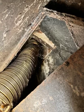

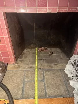

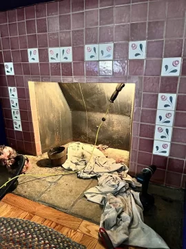

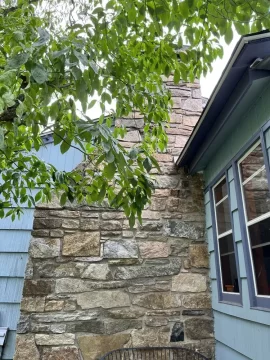

My wife and I bought a small ranch(1300ish sq ft) a few months ago and it’s been great, there is a large fieldstone chimney outside that is beautiful but there wasn’t a fireplace to be seen inside- the homeowners said that they moved in 20+years ago and covered it up- fast foward to buying the house we uncovered it to find what you see in the pictures.
We had a family friend come inspect the masonry from the foundation up and said it was in good shape, two separate flues for furnace and fireplace, needs very minor repair work, but my questions now are about a wood stove.

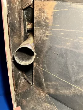

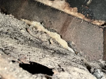

It seems the last owners already had an insert and done some modifications- and it also seems the smoke shelf has rusted through. From what I’ve gathered these things are irrelevant to my installing a wood stove?
We’d love to not have to rip the entire place apart and couldn’t really afford it, so is there a major concern? Or are we making a mountain out of a mole hill. This would be supplemental heat for our 1300ish sq ft ranch in the winter.

Tough to tell what the perspective is on that last photo, but I'm guessing you have a corrugated liner running up thru an old clay lined stack, and that you want to plant a free-standing wood stove in front of the opening of that fireplace. If so, you'll be looking for rear-exit stoves with an outlet low enough to clear the lintel of the fireplace, or else punching thru the wall above the lintel with a thimble, which will likely give better performance.

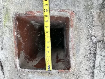

Either way, you'll want to get internal dimensions on the existing clay liner, which looks pretty easy to access from the chimney top. That will tell us if you have space for a new 6" liner, preferably blanket wrapped. Also, overall height from floor of fireplace to top of chimney is going to be a useful number, in your stove selection and planning.

It has a liner but it’s not insulated (and it’s old and has an unknown history). Chances are you will needed an insulated liner. Read up on the tax if you can take advantage of it.

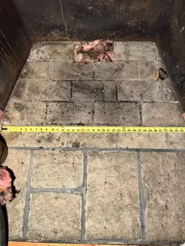

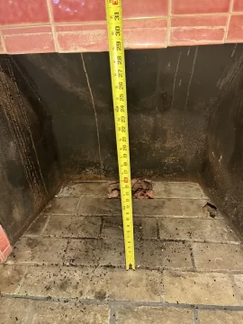

Ashful- you are correct, I took a few pictures of measurements

Take a look at 1.5-2 cu ft inserts. Ideally, for those that allow N/S loading. The True North TN20 insert, or the Pacific Energy Super insert are N/S loaders that would work ok here. The Drolet 1800i might work too. There are several 1.5 cu ft inserts like the Lopi Answer, Drolet 1500i that would fit, but for an easy install, measure carefully for depth due to the back slope of the fireplace. That may point you to a shallower E/W loader for easy install, or cutting out some of the back slope metal to accommodate a deeper insert. Another option would be a freestander that fits under the lintel and top vents. It looks like a box stove like the VC Aspen C3 will fit here.

The chimney's 11" ID clay liner will make for an easy pull for a new corrugated liner with blanket wrap. You'll need to figure out how to get it thru the old damper, sometimes this means some cutting there, but nothing unmanageable.
