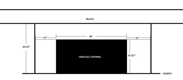

That old beast is flipping heavy, walk it out with an old 2x2. Could only get the outer dimensions of the fireplace opening H25.5" x W46" , looks plenty deep.
That sure is wide, I measured twice. Seems like many of the surrounds for the inserts are 44" wide, I believe the Century's is 50". Anyone know how wide the Englanders surround is?

I guess the picture is a bit deceiving. 25.5" height is not tall enough for decent size stove. You may need to go for an insert then. Another option would be the Heatilator WINS18: http://www.heatilatorecochoice.com/products/details.asp?cat=wood-inserts&f=WINS18 May not be quite as cheap as the other units but we had several positive reports about it and it is built really solid.

I see what your talking about now Grisu. Century says u need 20" to combustibles above stove. That would be a hair over 43" off the hearth for me, bottom of my mantle is at 36" :eek:
Okay, I could get something like that heat shield to work, my mantle sticks out far enough wouldn't look so odd. At some point we want to redo that holy terror of a mantle anyways.

The Century clearances just barely work with the heat shield. The unit stands 23 1/8" tall, and your allowed min of 11" to combustible top surround. I have 34 1/2" from hearth to combustible, leaving me 3/8" extra space... Its awful close, is that okay?
Looks like the Heatilator WINS18 doesn't meet my clearances even with its heat shield, the WINS18 is even 3" shorter, seems to have more strict
clearances.
