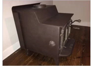

Hello.
Have a few questions I'm hoping ya'll can help me with.
Looking to purchase a Fisher Stove, have been looking at the pre 1980s models, but they've been hard to come by in our area lately. I've tried to familiarize myself as best as possible with them, but there is just so much information.
I've found this stove, what I think is a Grandpa. It says it has fire rope installed. From what I've read about the older ones there was no gasket seal or fire rope. Is this true with this model as well? Also what should I be looking for as far as it being in good condition? We're moving in a few weeks and hoping to get one installed in our new home immediately, to help with heating cost.
We run a regency i2400 now as the sole form of heat in a 1200 sq foot home. New home is just over 2500sq ft, and hoping to primarily heat/supplement the propane heater with it. Do you think this would work?
Thanks for any information you have!

That's a Series IV Grandpa. (looks like it has 6 bricks across back - Grandma will only have 5) All glass doors use gasket material. The stoves with no gasket use a steel channel iron around door opening to make contact with door. Stove Bright Metallic Brown. Sharp stove.
[Hearth.com] Questions on Fisher Stove
Heating area up to 2250 square feet. A blower can be hung on the shield at the bottom that blows up the back and forward across the top.
