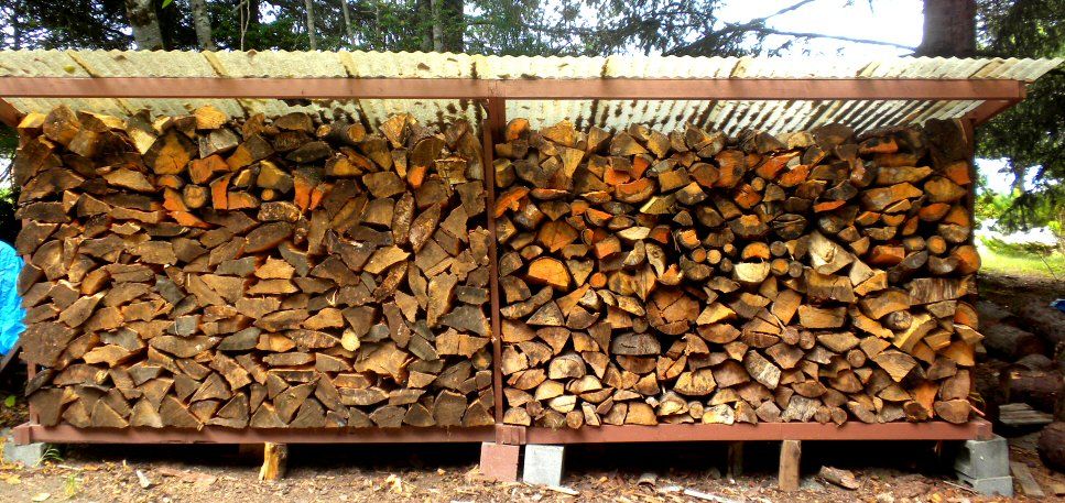

But I'd like to add more capacity. I don't want to spend as much effort on this project, so tell me whether you think something like this would work:
I get four pressure-treated 4x4 posts, and sink them into the ground next to my current shed. The posts would be 16 feet apart across the front, and 5-6 feet apart, front to back. I then span the tops of the posts with 2x6s, with wiggle board on them, and add the same corrugated plastic roofing material. It would be open on all sides, as my current shed is. I'll worry about the flooring later.
Do you think this would work? Anyone have something like it? I don't want to put in too much effort, since I don't expect to have this much wood in the future.

It's a one shot deal. One and done. Doesn't require that much effort. Git er dun and enjoy dry wood for a few years.
Oh, and it should work just fine as long as you don't get much snow.

No snow here! How deep do you think I should bury the 4x4s?

I guess my main question is whether burying the posts is a bad idea. I know that I did this for a hammock stand, and the post is still there years later, with no visible rot.
Also, since we never have snow here, I'm considering having the roof almost level. Problem?
I would put at least a mild pitch on it. Debris will have a tendency to collect over time. Let mother nature and a little rain do the work for you.

Yeah regardless of snow I'd want a slant for other various things that may drop from the sky
Is a roof really that important? I generally just cover my wood if there is snow predicted... Should I rethink the roof idea?
Either way is okay, having a permanent roof is just a convenience factor

Without a roof it's not really a shed now is it? I'm planning one for this summer as well but wouldn't consider not putting a roof on it. Otherwise it's pretty much What I have now. Piles of wood.
If we can build shed w/o roofs, then I have almost 200' of shed in the back. Not including the one in front.....with a roof.
This is very liberating.
With a roof, there's no need to concern yourself with whether it's going to rain or not. Or snow. Or sleet. Or ice.

Only concern I'd have would be wind. If that faces the wind then it could be a potential problem. Sinking those posts also is no problem but I would not have a level roof. I'm sure you get rain there even if you don't get snow.
