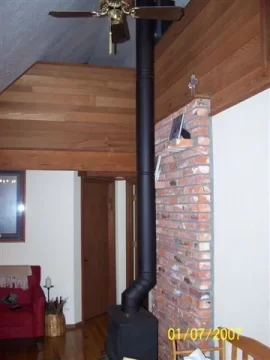

Will a normal fiberglass cleaning rod push a 6" wire brush thru 2 6" 45 elbows w/o getting stuck?

My guess is that it might, but looking at how close they are.... I'd probably say it wouldn't. It would probably make the first turn, though.
I think you might be better off removing the 45's and let the soot drop into a tightly sealed bag at the end.
If done from the top down i wouldent wory about trying to go through the els as they are
so close to the stove.
They make a very flexible one that you could use as the rod with the brush on it and then the stiffer ones for the rest, but I agree. Those elbows are close enough to the flue outlet that they are going to be the cleanest part of the pipe.
BTW: Thank you. I have been concerned about the two or three pounds of liner weight being exerted on the 45 degree elbow into the top of my stove. Not any more after seeing yours.
back to back 45's , it aint happening , you will get it stuck , dont attempt it. better to clean the 45's from below if you can with your unit , they wont be that bad anyway as they are right at the stove top. but you will not push a brush through them with a flex rod if back to back unless the brush is too soft to do the job.
Yup - I'd agree... those 45's are going to be the cleanest part.. It really depends on how you were planning on capturing the soot at the other end (I was assuming running the brush from the top). If all of the stuff is able to dump into the stove and you have access to the flue outlet to run a hose or something to vacuum out those 45's - you shouldn't have any problems cleaning it, and I wouldn't worry about getting the brush that far down.
If there's some baffle at the top of the stove that you cant get above in order to clean out the soot, then I think you have to take the 45's out to clean it and be sure you get everything. I don't think any flex rod would be able to go up from the bottom - that's a little bit of bending to do.
