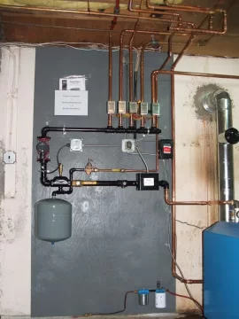

I feel that the Grundfos pumps are built to the most precise tolerances, and are the quietest. The design of the impellers, volute machining and outer motor casing just seem to be well built. I was at the Grundfos Fresno, California plant a few years back. I watched them building the 15-58 and there is a lot of attention to quality control.
I would agree the Alpha is an excellent choice, I just bought 4 of the to upgrade every pump in my system and on the solar also.
I have a Taco Bumblebee on my system now, it is extremely noisey on the two highest speeds, for some reason, a whirling noise of some sort.
The blower motor in the mod con boiler that they add will be the loudest component in the system. seems the brands of boilers with the plastic outer cases dampen that noise best.
I'm with Heaterman and you can put the ZV's on the supply if you want with no banging.
