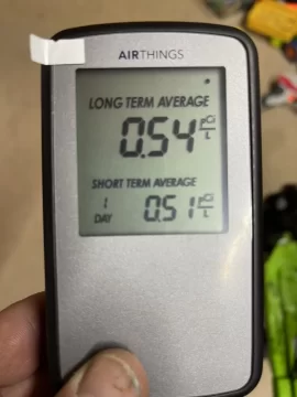

I have the same meter posted in the first page. It was dead on with the "professional" meter that was left in our house several days prior to mitigation install and also after the install was completed. I would trust it's reading.

First things first, pay for a real radon test with a true calibrated instrument, you used yours, it gave you the indication that there was the possibility of something wrong, now get the real test to confirm it then think of remediation.
Agree with this. Your cheap Chinese Amazon tool told you something might be worth looking into. I would pay for a professional test and go from there.

I wish it was cheap. Those meters are $150! It looks like most people reviewing it on Amazon have a similar experience with them as I did - I know my particular unit is calibrated correctly at least - cannot speak to any variation between individual units

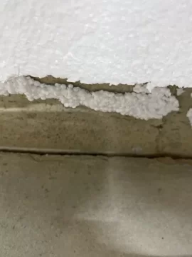

Update. Making great progress!
Got up this morning and we are down to 5.45. We have most of the floor cuts/cracks sealed. Started on wall/floor crack yesterday. About 1/2 done. Finishing today.

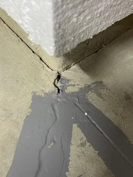

For anyone reading this in the future. By far the wall/floor seam made the biggest difference. Once we started that yesterday the levels dropped all day.
Where the seam was accessible i cleaned, dried, and caulked it. Where there was foam board and drywall i cut bottom 1" away and spray foamed with closed cell foam.
Finishing today. I'll post another update

Couple of pictures from today and likely the biggest offenders, the wall/floor and relief cracks

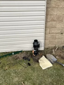

All cracks sealed.
4"dc duct fan hooked to foundation perimeter tile.
Perimeter tile has been unused and buried since 2003. Figured I'd give it a try.
Im gonna turn off today and monitor levels for a few days to see if the ventilation is necessary.

All cracks sealed.

Im hoping i don't need the fan. If i do i did get a dc fan so it has 10 speeds. I'll find a speed that is sufficient.

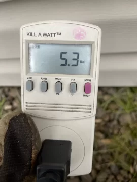

Update #2
Turned off fan. Took about 2 days and radon levels returned to about 5 range. Looks like sealing all the cracks got us from 15 to 5.
Within hours of turning fan on levels began to drop again.
Turned fan to 50% speed to see if that will maintain low levels.
Fan is only using 5 to 5.3 watts on 50%
