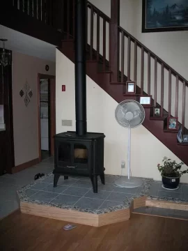

My hearth is raised about 6-7" above the floor and I have 19" offsets to the trim boards from the front and side doors. Personally I like it that way as it gives the room a bit of character and do not find it at all inconvenient to load or maintin the stove. I find its actualyl fairly comfortable to squat down on the floor, open the door and toss in some logs.
