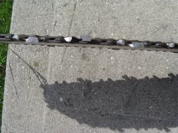

I put a chain on my Dolmar 5100 and the raker's look different than the chain I took off. Could someone tell me what this chain is and how aggressive it should be?

from what i can see it looks like they are bent over and rounded off, if that is right then thats the new style of saftey chain
Hard to tell from that angle photo, but I would agree possibly safety chain on the rakers, looks like a full chisel design on the cutters.
Where did you purchase it, and what is the make / part number?
If it came from a "Big Box" store, it's almost 100% certain that it's a safety chain, as that's all they sell.
If you've run it, you own it, but if you haven't, you might consider taking it back and getting a pro-grade chain.

Its a used chain from a buddy, I will have to ask him about it when I talk to him again. Wasn't sure when I saw the rakers were bent over like that.

It does look like Oregon Vanguard (full-chisel low-kickback), although everybody might be making that style of raker now for all I know. FWIW, I think it cuts fine.
That's the chain that came on my 5100. Rebadged Oregon Vanguard. A little time with a die grinder will fix it right up. I just ground all of the side layovers off of mine. Cuts fine now. Happy with it when new but after first sharpening, I was less than impressed.

rakers needed dressing after first sharpening... ground them down pretty good so it would cut better and went out a got a good (non safety) chain to be my main "clean wood chain"
Now I use that original chain for "dirty wood"
