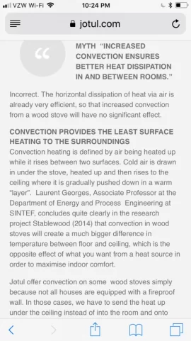

I feel I need something like Jøtul Castine 400 or albeit less attractive pacific energy small to mid size unit like the Newcastle. Also not totally against cat stove. I’m not even sure if the 400 is convective but I probably want convective as to not get too overheated.

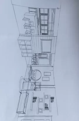

We have a 8 ft ceiling ranch see pics. Stove will go against stairwell a change from floor plan Open floor plan but there is a 10” header beam that will trap some air and long hallway. So not much heat to bedrooms
Living room 270 sf. Kitchen 260 sf. Dining 150 sq ft. This area heat can easily reach I think. Then mud room 270 sf office 144 sf a little.
Hallway 70 sf plus other rooms and master total another 1000 sf but not sure I even count them.
Full basement insulated to 2005 specs.mud room is stepped down.
