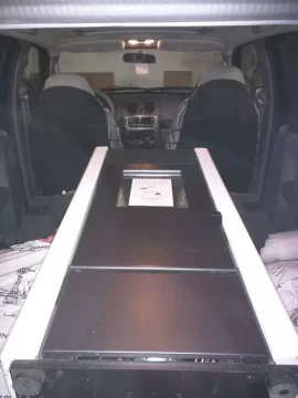

It's home
I hope the triangular shaped flame trap plate wasn't rattling around during transport, gouging-up the firex in the firebox....

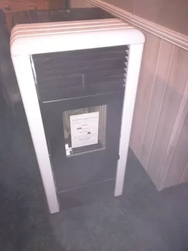

It's in the house at least

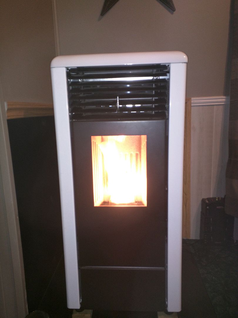

And we got fire
