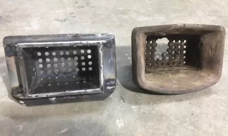

We have owned this stove for 3 years have have gone through 4 burn pots, they only seem to last a couple of months! I'm not sure this is covered under the warranty because our dealer charged us for a replacement 1.5 years in
There's a discussion about this on another forum. It's a common problem. They only last a year or so. Cast Iron just doesn't cut it. Cracks and burns out. I just made/welded one out of mild steel from Home Depot. It's been in the stove for a couple weeks now.
