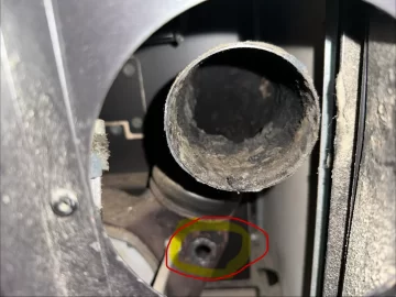

Hello.
I bought a used RV100
Classic. Looking at the exhaust connection, I see a small (approx 3/8” dia) hole in the exhaust manifold. Is this for some sort of exhaust probe / sensor that it not installed?
Stove is dirty and will get a good
cleaning prior to install. 👍
Thanks.

I have an RV100 Classic. I'll take a peek back there when I'm home and see if there's anything.

I had my stove open today for cleaning and I cannot figure out the angle on how this is a part on the RV100 Classic...This is the pipe that you connect to your chimney, or is this the pipe that is the inlet to feed air to the fire? Does your stove have decorative tiles on the sides or is it colored metal?
On my stove the inlet has a flow sensor -
the outlet has a clear rubber tube that is pressure sensor and "smoke sensor" that I think is a thermocouple
It goes through this grommet
and looks like this
