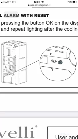

Manual says to reset thermostat button [Hearth.com] Ravelli rv80

Make sure that the connectors on the motherboard are seated properly. Did you check the safety thermostat switch, usually located somewhere on the back of the stove. Usually has a round black plastic cover (looks like a tophat), unscrew the cover to reveal the little red reset pushbutton.
