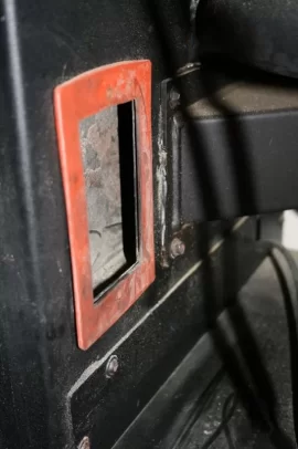

The only difference I have in my cleaning routine (compared to Pelleting in NJ) is that I use a inexpensive dryer lint brush in the side clean-out ports. At the end of the year at least, I pull the exhaust blower, paint brush to clean ash off blades and vacuum the area. I also disconnect vac switch to make sure ash has not clogged the port on the exhaust housing. My venting cleaning is easy as it is a 3' horizontal only. Attached are a couple of photos ...

  • [Hearth.com] Ravelli Sophia Stove burn pot fills fast
