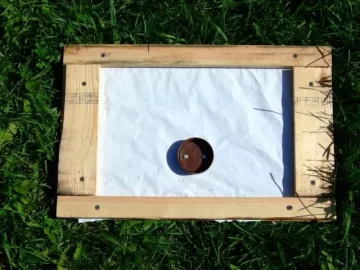

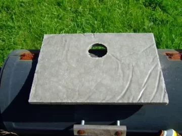

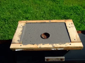

Bought castable refractory cement at ACE hardware, let it dry for two days then cured it in my barbecue grill as it does smell a little when curing. [Hearth.com] Ravelli vermiculite liner replacement (RV-80) [Hearth.com] Ravelli vermiculite liner replacement (RV-80)[Hearth.com] Ravelli vermiculite liner replacement (RV-80)
