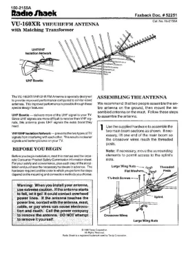

I'm thinking of upgrading my TV antenna as it is a bit beat up and missing a vane.
Right now we're in a location so that we are able to pull the TV stations from the two "metropolitan" areas of Bangor and Portland . . . although one of the stations in the south (still using VHF I believe) sometimes cuts out. My wife also noted that when it is windy sometimes the stations cut out as the antenna (roof mounted with a rotor) moves a bit.
Wondering if folks have any specific recommendations on an antenna upgrade which will continue to give us the stations we have now . . . and perhaps clear things up a bit.
My current TV antenna is a Radio Shack/Antenna Craft VU-160XR.
Wondering specifically about the HD Stacker (seen on DennysAntennaService and reportedly made by Winegard) and Winegard HD8200U.
