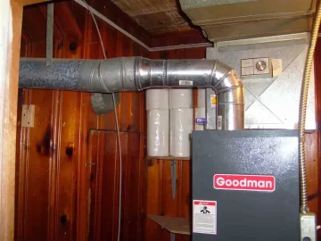

My furnace is a new good man and puts out 56,000 btu, intake is 70,000. the hot water heater is a 40 gal, 34,000 btu.
The first image the furnace, just behind it is the outside wall and I think i would go straight up somewhere around there

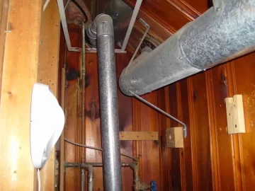

the second is how they are curently vented

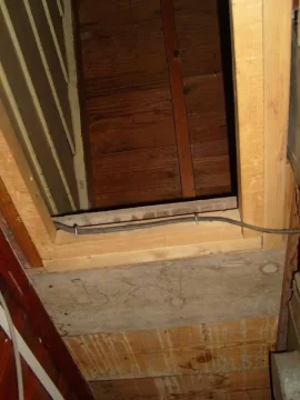

The third image is of the small actic space obove the utility room.

I'm still shaking my head looking at the middle picture did you know single wall vent pipe has 18" to combustiables? the place a heat shield at ceiling level for the gas hot water heated but 2/3 up the wall the heat from the pipe has turned the knotty pine dark. Just for assumption somebody may hace got the furnace pipe right with double wall pipe but the hotwater heater the installer had a brain Phart.. You need to speak to your gas inspector to figure out what he will alllow. I can quote code all day but he signs off the permit and inspection. What provisions do you have for combustion air?. Her what I would do call your inspections office and speak to the gas inspector and ask if he can take a peak at you situation and offer suggestions .He sees exactly what you have and listens to exactly what you are planning. You can get direct feedback. Almost all members here are not qualified to answer your questions.
We had just bought the house a year ago and I am find all types of jerry rigging all over the house. My next call is to the inspect office but I like having an idea ahead of time.
