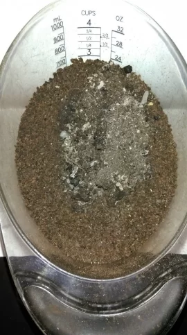

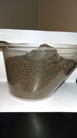

How's this for ya....Freedom Fuel.....23 ounce ash volume.....ash weight 2.40 ounce.......ash percentage .37%....but the biggest ash cake I've seen this season....
