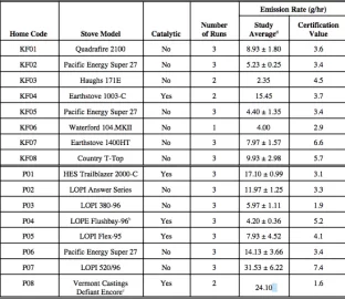

And to beat the dead horse even further, the enclosed chart shows what the stove put out - in comparison to their rated GPM by the manufacturer.
The Defiant Encore, which was rated 1.6 GPH by the manufacture, put out 24 GPH
The Pacific Energy Models (3 on the list) were rated at approx 4 GPH by the manufacturer....
one put out 5.23
one put out 4.40
and one put out 14.33
My goodness, learning something new every day.

My reaction is that it is a fascinating read, but they seemed to be getting a great deal of soup from very few oysters... 16 stoves is a TINY number, and I would wonder about problems with sample sizes to begin with. It seems that the data they said showed no correlation on things like wood moisture I think reflected the fact that the samples were so small that there simply weren't enough data points... All but one of the cat stoves were in the Portland group for instance, which had both higher emissions and higher moisture.
I would say the study is interesting but woefully inadequate to draw any meaningful conclusions from...
1. Need a MUCH bigger sample size, probably several orders of magnitude larger - more like 1600 stoves than 16
2. Need evidence that stoves chosen were representative of the population in brands, level of maintainance, useage patterns, wood moisture levels, etc...
3. Need more of a geographic spread to cover more climates.
4. It would have been interesting to bring the "impaired" stoves back into spec, and perhaps do the "missing" routine maintainance on the others and see how / if that helped the results, etc.

Web,,,,,WAY TOO SMALL a sample size AND I think that the Defiant getting the black eye at 15 times its certified output tells you something was wrong......plugged cat ot not being used properly or something else.....no other explanation for it being so out of wack......same can happen with cars...test one where the owner never changed or cleaned the PCV, air cleaner, plugs, etc and you get a polluting automobile......same with stoves....don't maintain the cat or use wet wood, etc, and you get bad results........and I don't buy that line about wood moisture not affecting GPH.........
It does make sense that the non-cat stoves would show the least degradation over time though, especially when not maintained well as they're the most simple and require the least user intervention. What doesn't make sense is the wide range of values seen. I have to wonder if the same fuel was used in all the tests.
No one would claim that 16 houses is a large enough sample.
However, the conclusions stand pretty well - that being that test result per current EPA testing do not correlate with stoves in the field using cord word. I agree that the Encore test stinks...and would think that if they tested 10 encores they would do much better.

I agree the study was conducted on a small scale, and they probably could of gotten better numbers from a couple of stoves just by extending the chimneys a few feet. I think there were 3 stoves that had 10' or less vertical. Not much draft for proper burning. Maybe they should of made sure all stoves were setup to manufactures recommended installation specs. But then again, in the real world, some people don't read or follow directions, and you will have bad installs.
I'm a little surprised there hasn't been any other more recent studies out there.
The cat stoves sure seemed to pump some junk. If nothing else, the sample size shows a large difference between certified and actual numbers.
I agree, shopping "by the numbers" isn't real useful, which is why you might have noticed I do NOT consider EPA numbers in anything I've ever suggested, and don't plan to. At best they might be a far secondary consideration if choosing between two otherwise equally good stoves, which is seldom the case.
However looking at the study, I saw lots of stuff on the Encore in particular that made me suspicious.
1. They had less to say about that stove's condition than they did about many of the others, particularly the KF stoves. It felt like they didn't do as thorough a job evaluating it as the others. Among other things they mentioned rain leaking into one corner of the stove, but no discussion of what that might have done to it's condition.
2. It was one of the oldest stoves in the study, installed in '89, where most of the others were installed a couple of years later.
3. While they said nothing about the cat's condition beyond that it was cosmetically OK, it sounded like it was still the OEM cat, which may have been approaching EOL just from age.
4. The use descriptions weren't consistent with the amount of wood claimed to be consumed.
5. While drier than some of the other Portland stoves, they were still burning 25% moisture wood, which is worse than we reccomend here
6. They didn't give stove temps, but the stack temps they listed were pretty low, suggesting the stove was being run in "smoulder mode" most of the time, or at least at a much lower temperature than Elk claims to run his stove at.
7. While the chimney height was good, it was going into a masonry flue of unspecified size - might they have been pushing the cross sectional area?
8. They only had two weeks worth of data on that stove, most of the others had three.
Seems to me like any of these conditions could have been enough to cause the stove to do worse than a more typical Encore might have otherwise have done

for the record, the manufacturer doesnt make up the GPH rating on the cert card they put the GPH total specified by the testing agency on the cert card. this card must be attached to the unit when shipped to the dealer/ retailer. usually it is attached to the door to the unit. this tag with the proper GPH numbers and efficiency rating are required to be posted in this way by EPA. so , in reality the GPH rating is not by the manufacturer, but by the testing agency.
