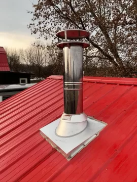

Sad, this is like one of those 'find 10 things wrong with this picture'. The good news is that you had the wisdom to ask for help.
It's a tear-out. In the end it could be that only the stove pipe is saveable.
Its not a good situation, but your alertness caught the error, good luck with getting it corrected.
Thank goodness and the Lord no one was hurt, this can be fixed. Like your stove too. Good luck.
I’d say you’re EXTREMELY LUCKY nothing bad has happened. I would 100% take this man to small claims court if he didn’t give me every cent of my money back (minus the stove price).
Yes, we are quite thankful to the Lord that nothing bad happened! Stovepipes can be fixed, and money is replaceable. The inspector checked it out this morning and flagged everything that's been mentioned here, plus he said that the cap is wrong for a wood stove, being the style intended for a gas furnace. (The slots are too small for wood, and will plug up.) Between parts and labor, he estimates it will be about $2K to fix the situation. Ironically, he thinks the installer's misuse of insulation is probably what saved the roof opening from leaking this spring.
Small silver lining: The inspector (who will also be doing the repair) thinks we are safe to bend the 10-3-2 rule in this particular case, because the chimney is on the west side of the roof and the prevailing wind here is from that direction. He thinks it would be a problem if it were on the east slope, but since it is where it is and has a history of drawing just fine, we're safe to leave it the same height.
I have reached out to the installer, who is at this point unrepentant. Even in the face of photo evidence, he insists that the B-vent is actually Class A chimney, and he also persists in the belief that fire-rated spray foam is acceptable to be in contact with the pipe. (This also despite pics of the scorched and melted foam.) He has requested a copy of the inspector's formal report, which I told him I will happily share.
If he doesn’t think the 10-2-3 rule applies in your situation, how can you trust him as a professional? This is code..
There is no code in our county, so there's some flexibility. He's been in this business locally for 45 years, so I would give a fair amount of credibility to what he says. Also, code or not, nobody has told me what actual difference that makes as long as the stove is drafting properly (it is) and the roof is metal (not prone to ignite). Seems more like checking a box that doesn't make any real-world difference in my case.
The code is an international code. It applies everywhere, unfortunately it’s not enforced everywhere. You are in an area that’s not inspected unfortunately. This would have been avoided if codes were enforced in your area, and the installer would be liable.

Yes there is code in your county. There might not be code inspectors but there is still code that needs to be followed. It looks like your already on the short side for your chimney just do it right.

Try telling your insurance company that there is no code in your county. I would wager that they feel differently.

Well, besides what everyone else has said, do this.
Go and download the installation manuals for triple wall stainless steel (HT) DuraVent pipe and see everything that was done wrong just for pipes designed to withstand 3000+ degrees. Never mind if he had used real double wall chimney pipe. If you had had a chimney fire there is a good chance your house could have burnt down.

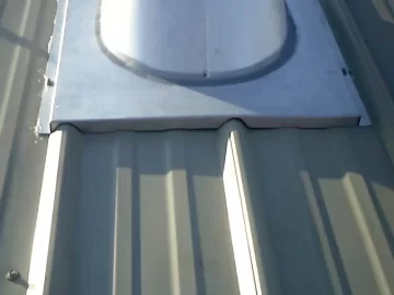

Good that it's Duratech double-wall. Be sure the installer does not buy a rubber or silicone boot for the roof flashing. Excel and Ventis make decent metal roof flashings. The rest of the parts can be DuraTech. Note that the DuraTech cap screen is a bit on the fine side and will clog up quickly if the wood is not fully seasoned.
Also, be sure the installer knows the proper way to install metal roof flashing. We see a lot of jobs that are not done right. It gets notched on the bottom edge to conform to the roofing and the upper side of the flashing gets tucked under a slit in the roof metal.
