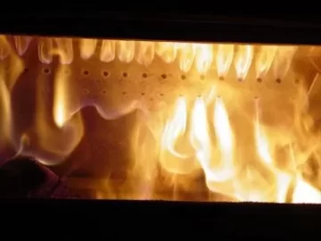

    LUCKILY I'm a picture saver. "Pacific Energy Summit secondary burn chamber / secondary burn flames"

    Man, I get toasty just looking at that pic :coolsmile:

    To clarify something here, that picture shows the flames that appear like gas coming from a gas grill burner. At least in my stove, there appear to be 3 different kinds of flames.
    First: Primary combustion flames that are like what you'd see in a campfire outside directly coming off the logs
    Second: What I think of as secondary combustion, which is the huge rolling ball of flames that seems to be everywhere in the fire box and is lit off by the primary. I believe this to mostly be the smoke being burned. Frequently it rolls down the glass, appearing to hang in the firebox.
    Third: The jet like flames that look to be coming out of the burn tubes like a gas grill. These can sometimes combine with the flames I mention in the second type and can wrap around the top of the firebox and into the upper chamber of the stove it it's a really roaring fire.
    Is this similar to other folks experience?

    Yep. And when sharply dampered down, the flames often go blue and waft in mid air above the fire.
