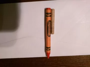

Be glad your not burning these crayons, I been burning all season. [Hearth.com] Really tired of the small auger

The Serenity and the Ravelli have both been eating up those long pellets in my pic above no problem, but I do notice more of a flame size fluctuation burning them over a standard size Pellet.
