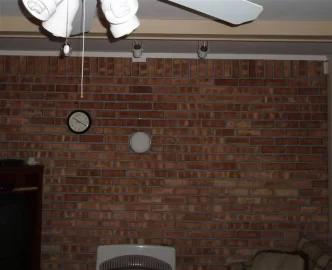

The wall my stove will be placed on is a brick wall. Is it safe to assume this wall isn't considered combustible? If the stove calls for 10" on the rear would you still follow this or can it be closer?

What's behind the brick? Standard 2x4s?

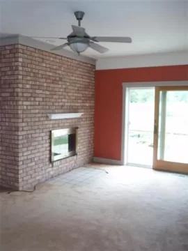

Good question! The other side of the wall is the fireplace in the living room(attached) but I'm not sure if the wall has studs between.

Brick wall facing wood studs isn't considered protection in and of itself. It's non-combustible, yes, but an unprotected surface per NFPA 211. You will want to pay very close attention to how your manual calls out clearances - you will likely not be able to reduce clearance w/out adding protection (i.e. air-space).
What kind of stove is going in here?
And while we're at it - am I reading this correctly that there are two brick walls back to back w/ that fireplace(?) in between? Tells me there could be a large masonry chimney plunked thru the middle of the house there - not stud walls? I see the old thimble blocked off - multiple flues do exist? Or this install is going to add a new pre-fab chimney parallel to the existing one? I'm kinda wondering if the true construction is really known here.

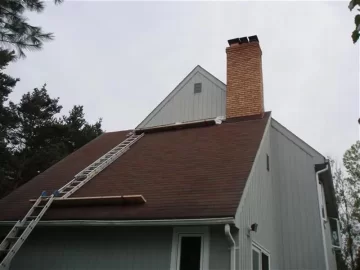

This looks like what we have here. It's a solid hunk of brick in the middle of the house with three flues. If you can see this from up in the attic and all four sides are brick, there should be no combustibles in there (save perhaps some creosote deposits). Looks to me like that is what you have, clean up to above the roof. But you better be sure if you intend to push clearances. Something doesn't look quite the same in the two views of the two sides you show. The brick colors and fireplace widths both look different. You're right to be worrying about this.
I can see all four sides of my brick at the basement, attic, and roof levels- three sides on the main floor, with a little drywall in a stairway covering one end of it.
