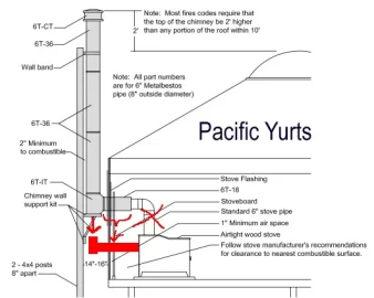

I have a question about taking a rear exit flue through a yurt wall. The stove is a Jotul F100. It has the capability of top or rear; the collar is currently in the rear and for aesthetics is our preference. Every picture I have seen for yurts uses a top exit then an elbow to go out through the wall (through thimble and flashing) and into the T. My question is: Can I instead run my stove pipe straight out through the wall to the T? Would I need to slope that run slightly up? Diagram below (credit Pacific Yurts) showing in red what I am talking about. Any considerations to keep in mind, or something I haven't thought about that makes this less common (or not done at all)?
Thanks for your time!

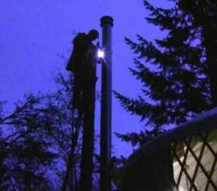

Horizontal runs should be kept as short as possible, especially with a short chimney. For this reason, we installed from the top. It also made it easier to do through the wall passage. We came off the stove with a 45 and offset to reduce the resistance of a 90º elbow. On this Morso, the config works reasonably well. There can be a little smoke spillage with outdoor temps above 45ºF if one is not careful, but not bad. Top-down starts work well in this case.
Plan on adding another 3 ft to the chimney to take it up to 12' (could do 3-48" lengths). The Jotul F100 manual says:
Chimneys shorter than 14 feet (4.27 m) may not provide adequate draft.
We wrapped this up at 12' just after dusk.

The more vertical rise you can get before your wall penetration, the better. The less 90s, the better. So while your diagram will probably work, Bergen's example will smoke you out less often on mild days. If you really want to make the stove happy, consider a straight vertical shot through the roof. (Not sure what a "yurt" is, so no idea if it's multilevel or what the roof is made of.)

Straight out the back of the stove eliminates a 90. The only reason I don't like to do it that way it because it limits your options if you want to change stoves.

With a short chimney and a shallow firebox stove, I wouldn't do this. Especially in a mild climate zone. That is why the 45s instead of a 90.

The manual says not to exceed horizontal runs over 36"; with the straight shot out the back it should be less than 24" (rear clearance to the wall is 8", and clearance of the chimney to the exterior is only 2" with triple wall). As mentioned, it would eliminate the 90, but I don't know which factor takes priority: the elimination of the 90 or the initial "up" of the top exit. Which setup would draw better and keep smoke out of the yurt on start-up?
I am not overly attached to one way or the other and will change to top exit if the odds of success are better. Once I cut a hole in the wall, it's there for good.

Like bholler said, the downside of a rear exit like this is that one is locked into the stove's rear vent height.

My pure speculation is a horizontal run directly out of the stove is an invitation to having a tough time getting the stove started. A fully exposed chimney already introduces a tough starting condition to begin with. My guess is a short vertical outlet starts to create a bit of draft when the stove is initially lit while a horizontal run does not leading to smoke being puffed out the air vents. Once the stack is hot its not an issue. My guess is you may need to buy a torch to encourage a draft in cold stove more often.

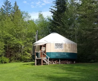

I just want to mention for others who may read this in the future that with most of the major yurt manufacturers, the odds are you will void your roof warranty if you try to pipe straight through the roof fabric. That is why they provide a through-the-wall kit. Most of the big manufacturers provide a 15 year roof warranty, which is nothing to sneeze at.
My preference for mine was through the wall, from the top. Here is a pic of mine right after I installed it. Afterwards, I changed it to two 45s which did help:
By the way, I hope this isn't spammy or anything, but I recommended @blueridge come here with these questions after he asked about them over at my forum. You all have helped me so many times here, this is clearly the best place for him to ask any questions about wood stoves!
