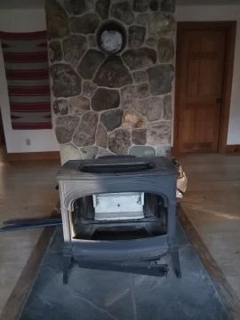

It's time (actually it's past time)--rebuilding the Encore 2550 after 23 years of rock solid performance as primary heat for our home. Plan was to do it this summer but unfortunately other more immediate demands took precedence, so now my back's against the wall with winter just around the corner. We've got a heat pump for backup so I think we'll be OK if I can get this done before Thanksgiving.
Issue is an air leak on one side where the top meets the side plate. Not terrible (I tried sealing it with stove cement from the outside) but it's vulnerable to overfiring if you're not careful. Haven't had any serious incidences of overfiring yet but don't like not having the ability to shut it down hard if needed.
This will be the first full rebuild for me so thought I'd share images and process, ask questions from folks who've already done this to their Encore.
Any tips, warnings, or recommendations before I tear into it any further? I have an old VC guide for rebuilding the Defiant which is somewhat helpful but does anyone have a similar guide for the Encore?
I've removed a lot already, I think the next step is probably the fireback and refractory assembly. Here goes nothing!

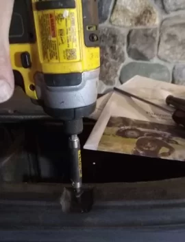

Got the inner sides out, bolts were very cooperative (I'd had them out maybe ten years ago to replace gaskets so I may have antiseized them a bit, can't really remember. Definitely will this time.)
Removed flue collar, screws were a bit seized to the square nuts they're threaded into but managed to get them loose without much trouble. Always my biggest fear with a job like this--the old seized/stripped bolt extraction!

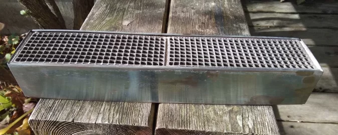

I removed the upper fireback this morning, just took 5 minutes of fiddling to get the right-hand side to clear the rib on the side plate with the damper rod still in the hole in the left side. I was expecting a lot worse. Here's a manual on the procedure in case anyone else is tackling this.
So far everything looks in good shape--no cracks, warpage, or other signs of damage. The throat hood is a bit warped, probably should replace it, but other than that things seem solid.

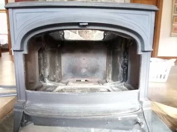

Removed refractory and heat shields, I think we're ready to disassemble the plates (gulp). Any tips/warnings? I know not to whack the cast iron with a hammer, I guess use a block of wood between hammer and stove? Or gentle taps with a rubber mallet? Help me out anyone who's done this before.
Here's how things are looking at the moment:
